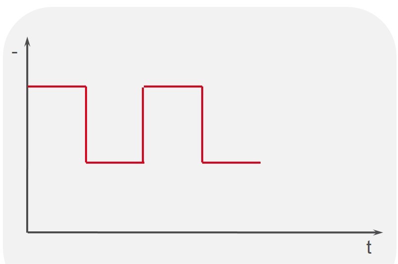

Hard rectangle
With this configuration, the system switches from the high pulse current to the base current and back very quickly. In the diagram this shows up clearly as a “hard” right angle.
![](https://blog.perfectwelding.fronius.com/wp-content/uploads/2021/08/DC_Rechteck_Hart-1024x482.jpg)
Effect: The fast switching of the arc also gives it a “hard” tone, acoustically speaking. This also results in rapid cooling and heating of the weld pool. This in turn prevents melt advance in the weld pool while producing good penetration at the same time.
Applications: mainly for butt welds for pipe connections —without filler metal up to a material thickness of approx. 3 mm.

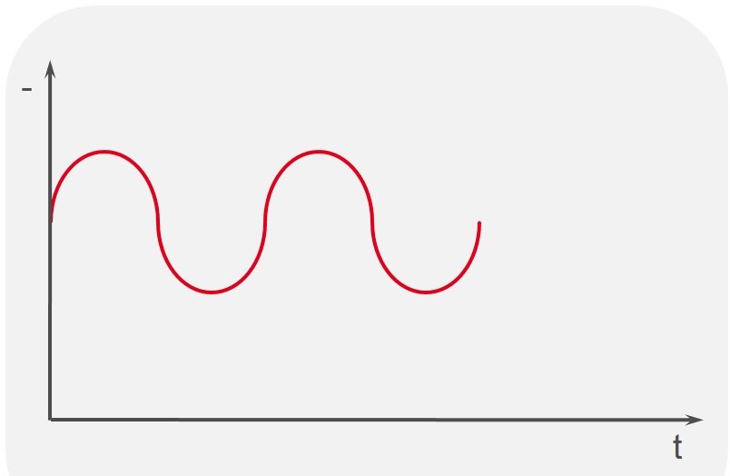

Sine
Current switching is completely smooth and balanced. This produces a sine wave.
![](https://blog.perfectwelding.fronius.com/wp-content/uploads/2021/08/DC_Sinus-1024x481.jpg)
Effect: The arc is very “soft”. Slow reduction of power produces higher heat input. The weld pool only cools down and heats up slowly, which means the weld pool flows nicely.
Applications: primarily for corner seam joints and overlay welding.

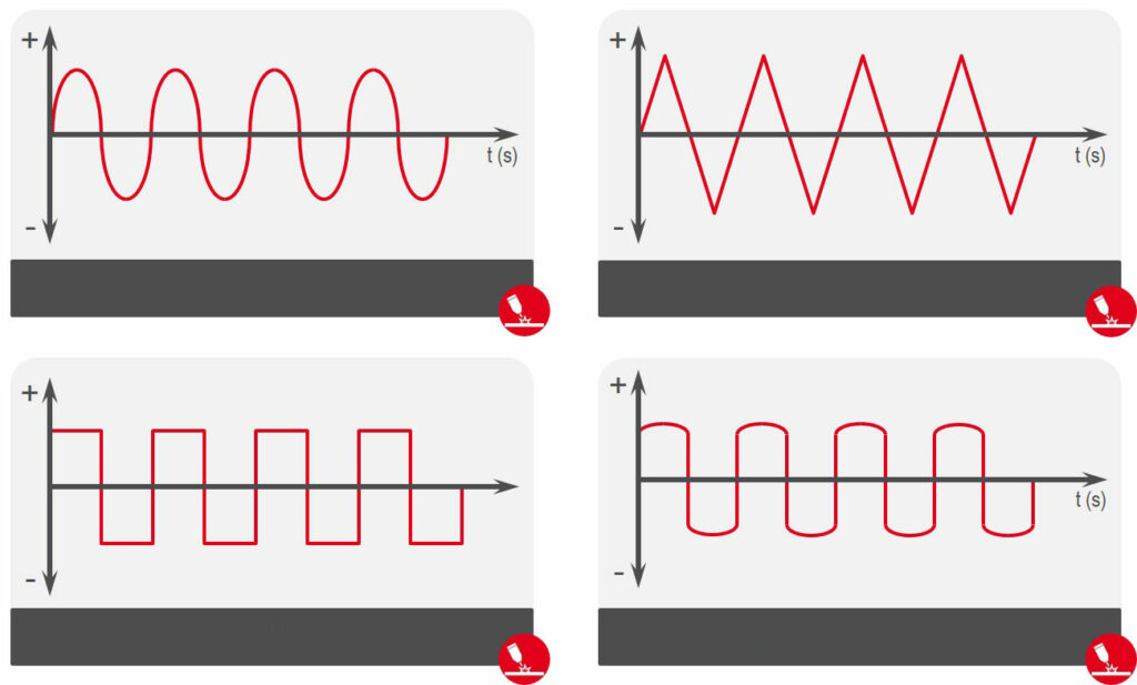

Different waveforms for AC welding on TIG welding machines
Factory-set configurations for TIG DC pulses—reflected in the different waveforms—already point to the fact that the alternating current can also be influenced in the field of AC welding.
![](https://blog.perfectwelding.fronius.com/wp-content/uploads/2021/08/AC_Kurvenformen-1024x617.jpg)
Of course, the amperage is not varied on the TIG welding system in this instance: instead, it is the polarity—i.e. the switching between plus and minus pole—that is manipulated. This results in different weld properties again …

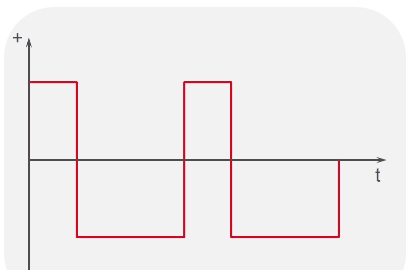

Hard rectangle
Switching between the plus and minus pole is very fast. This produces a hard rectangle when plotted on a graph.
![](https://blog.perfectwelding.fronius.com/wp-content/uploads/2021/08/AC_Rechteck_Hart-1-1024x482.jpg)
Effect: The goal is an extremely fast zero crossing of the half-wave. The arc becomes highly stable while a very loud, “hard” arc noise is produced at the same time.
Applications: This “hard” arc is still the standard today for many welders as they have always been used to it and it offers good welding properties. There is also the advantage that the arc can be used on very thick oxide layers.

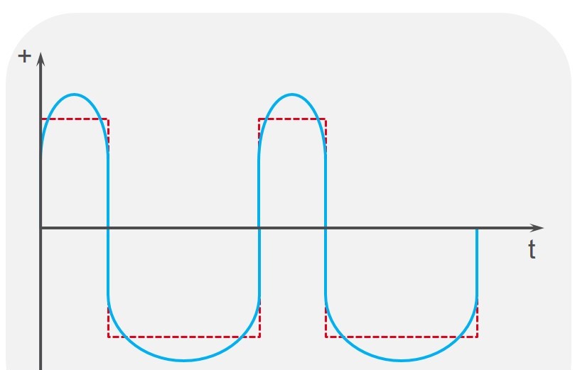

Soft rectangle
This waveform is an evolution of the “hard rectangle”. The switching between plus and minus is therefore not quite as abrupt as it is with the hard rectangle function, and not as delayed as in sine mode. When graphically depicted, the corners of the rectangle are rounded, i.e., “soft”.
![](https://blog.perfectwelding.fronius.com/wp-content/uploads/2021/08/AC_Rechteck_Weich-2-1024x471.jpg)
Effect: The arc combines the advantage of the sine and the hard rectangle modes. The result is a relatively stable arc, with relatively low/quiet background noise.
Applications: Due to these properties, the option “soft rectangle” for TIG welding systems is also theuniversal setting– for a wide range of welding tasks.

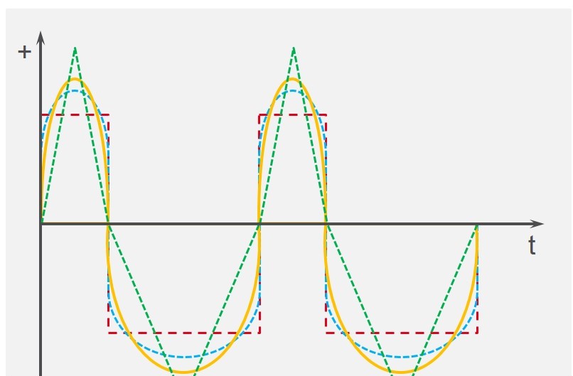

Triangle
The variation of the current between plus and minus is distributed entirely evenly over time. Therefore, when represented graphically, the half-wave produces a triangle.
![](https://blog.perfectwelding.fronius.com/wp-content/uploads/2021/08/AC_Dreieck-1024x485.jpg)
Effect: The zero crossing is therefore rather slow in comparison to the other waveforms. However, the even distribution of the current-time area achieves a higher peak current, although the mean current remains the same. This in turn results in a particularly high arc pressure. Acoustically, the arc is only slightly louder than the sine setting.
Applications: The high arc pressure means the triangle setting is particularly well suited for root passes.
