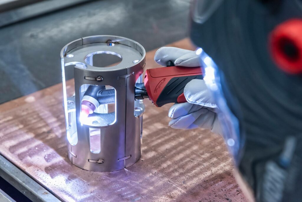

Which Handle is Right for my TIG Torch?
There are also various types of torch handle. Some are large, some are small. Most welders prefer smaller handles, especially for fine welding. Some handles are so slim that the torch can be guided like a pencil – ideal for delicate work. Essentially, it all comes down to which handle the welder feels is the most comfortable. The size of the handle also determines its weight and range of functions. A small handle, of course, has the advantage of being lighter. Large handles usually have a broader range of functions, such as an LED light, which can be used to illuminate the seam before welding starts, or may have various control elements. In addition, larger welding torches are better for applications with high levels of welding power, since they are more robust and can therefore withstand the higher temperatures.
