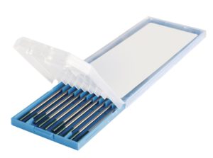

Tungsten Electrodes
The tungsten electrode is at the core of TIG welding. At 3380 degrees Celsius, tungsten has the highest melting point of any pure metal in the periodic table. This means the electrode can emit an arc that heats and liquefies the workpiece without itself melting away.
The electrodes are produced using a sintering process. They can also be alloyed using oxidic additives to improve their properties. The electrodes are color-coded according to the alloy used:
Tungsten/lanthanum oxide electrodes are colored blue
  • Pure tungsten (WP) (green):
    Flat, spherical electrode surface
    Ignition problems with DC
    Low current-carrying capacity
  • Thorium oxide (WT 20) (red):
    Excellent ignition properties
    Significantly higher current-carrying capacity than pure tungsten electrodes
    Slightly radioactive (alpha emitters)
  • Cerium oxide (WC 20) (gray):
    Similar properties to thorium
    Non-radioactive
  • Lanthanum oxide (WL 20) (blue):
    Longer service life than tungsten/thorium or tungsten/cerium oxide electrodes
    Poorer ignition properties
